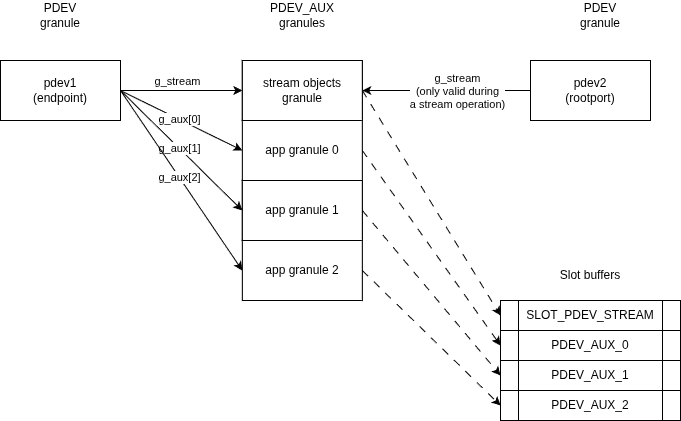

PDEV stream aux
Only endpoint PDEV objects own auxiliary granules that are donated by the host during PDEV creation. In the current implementation a PDEV stream always connects a rootport and an endpoint PDEV, so stream information is stored in the endpoint (pdev1) stream objects granule. Auxiliary granules are split into:
  • A single “stream objects” granule used to store PDEV stream state.
  • The remaining “app” auxiliary granules used as per-instance memory for the device-assignment app instance, as described in EL0 apps in RMM.
PDEV auxiliary granules are tracked in the PDEV structure and are mapped into slot buffers as needed. The stream objects granule is mapped through SLOT_PDEV_STREAM. The app auxiliary granules are mapped as a contiguous range starting at SLOT_PDEV_APP_AUX0.
6.2. Granule layout and role
During PDEV creation, the auxiliary granules are:
  • Transitioned to the PDEV auxiliary granule state.
  • Zeroed and then recorded in the PDEV structure.
The first auxiliary granule (index 0) is reserved for stream objects and holds an array of per-stream entries.
The remaining auxiliary granules are passed to the device-assignment EL0 app.
6.3. PDEV stream interactions
The PDEV stream SMCs operate on stream objects stored in the stream objects granule. These ABIs receive both pdevs as parameters, so the implementation can access the granule holding the streams.
At the start of a stream operation, the address of the stream objects granule is saved in the rootport granule so the rootport can access the stream state even though the granule was allocated for the endpoint PDEV.
The stream objects granule is always locked before being mapped in all the ABIs because it is accessed from other PDEVs. The app auxiliary granules are not locked because they are only used by their owner PDEV.
