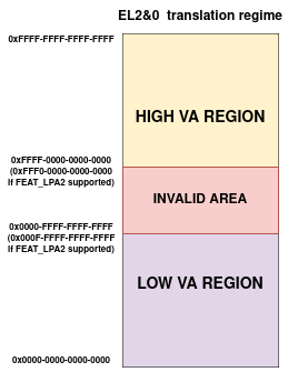

RMM uses the FEAT_VHE extension to split the 64-bit VA space into two address spaces as shown in the figure below:
full va space
  • The Low VA range: it expands from VA 0x0 up to the maximum VA size configured for the region (with a maximum VA size of 48 bits or 52 bits if FEAT_LPA2 is supported). This range is used to map the RMM Runtime (code, data, shared memory with EL3-FW and any other platform mappings).
  • The High VA range: It expands from VA 0xFFFF_FFFF_FFFF_FFFF all the way down to an address corresponding to the maximum VA size configured for the region. This region is used by the Stage 1 High VA - Slot Buffer mechanism as well as the Per-CPU stack mapping.
There is a range of invalid addresses between both ranges that is not mapped to any of them as shown in the figure above. TCR_EL2.TxSZ fields controls the maximum VA size of each region and RMM configures this field to fit the mappings used for each region.

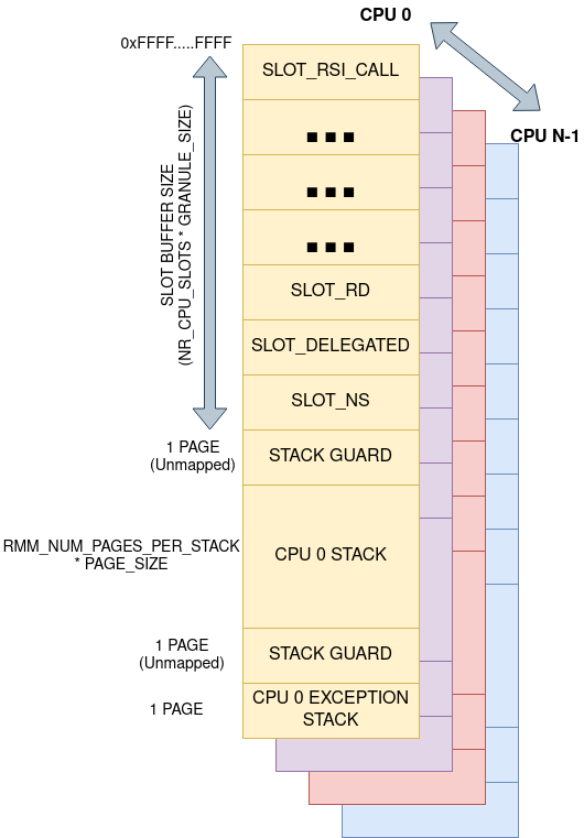

The High VA range is used to create dynamic per-CPU mappings. The tables used for this are private to each CPU and hence it is possible for every CPU to map a different PA at a specific VA. This property is used by the slot-buffer mechanism as described later.
In order to allow the mappings for this region to be dynamic, its translation tables are stored in the RW section of RMM, allowing for it to be modified as needed.
For more details see xlat_high_va.c file of the xlat library.
The diagram below shows the memory layout for the High VA region.
high va region
2.3.2.1. Stage 1 High VA - Slot Buffer mechanism
The RMM provides a dynamic mapping mechanism called slot-buffer in the high VA region. The assigned VA space for slot-buffer is divided into slots of GRANULE_SIZE each.
The RMM has a fixed number of slots per CPU. Each slot is used to map memory of a particular category. The RMM validates that the target physical granule to be mapped is of the expected granule_state by looking up the corresponding entry in granules array.
The slot-buffer mechanism has slots for mapping memory of the following types:
  • Realm metadata: These correspond to the specific Realm and Realm Execution context scheduled on the PE. These mappings are usually only valid during the execution of an RMI or RSI handlers and are removed afterwards. These include Realm Descriptors (RDs), Realm Execution Contexts (RECs), Realm Translation Tables (RTTs).
  • NS data: RMM needs to map NS memory as part of RMIs to access parameters passed by the Host or to return arguments to the Host. RMM also needs to copy Data provided by the Host as part of populating the Realm data memory.
  • Realm data: RMM sometimes needs to temporarily map Realm data memory during Realm creation in order to load the Realm image or access buffers specified by the Realm as part of RSI commends.
The slot-buffer design avoids the need for generic allocation of VA space. The rationalization of all mappings ever needed for managing a realm via slots is only possible due to the simple nature of the RMM design - in particular, the fact that it is possible to statically determine the types of objects which need to be mapped into the RMM’s address space, and the maximum number of objects of a given type which need to be mapped at any point in time.
During Realm entry and Realm exit, the RD is mapped in the “RD” buffer slot. Once Realm entry or Realm exit is complete, this mapping is removed. The RD is not mapped during Realm execution.
The REC and the rmi_rec_run data structures are both mapped during Realm execution.
As the slots are mapped on the High VA region, each CPU has its own private translation tables for such mappings, which means that a particular slot has a fixed VA on every CPU. Since the Translation tables are private to a CPU, the mapping to the slot is private to the CPU. This allows the interruption and migration of a REC (vCPU) to another CPU with live memory allocations in RMM. An example of this scenario is when the Realm attestation token is being created in RMM, a pending IRQ can cause RMM to yield to NS Host with live memory allocations in MbedTLS heap. The NS Host can schedule the REC on another CPU and, since the mapping for the memory allocations remain at the same VA, the interrupted realm token creation can continue.
The slot-buffer implementation in RMM also has some performance optimizations like caching of TTE’s to avoid walking the Stage 1 translation tables for every map and unmap operation.
As an alternative to using dynamic mappings as required for the RMI command, the approach of maintaining static mappings for all physical memory was considered, but rejected on the grounds that this could permit arbitrary memory access for an attacker who is able to subvert RMM execution.
The xlat lib APIs are used by the slot-buffer to create dynamic mappings. These dynamic mappings are stored in the high VA region’s xlat_ctx structure and marked by the xlat library as TRANSIENT. This helps xlat lib to distinguish valid Translation Table Entries from invalid ones as otherwise the unmapped dynamic TTEs would be identical to INVALID ones.
For further details, see:
  • enum buffer_slot
  • lib/realm/src/buffer.c
2.3.2.2. Per-CPU stack mapping
Each CPU maps its stack to the High VA region which means that the stack has same VA on all the CPUs and it is private to the CPU. At boot time, each CPU calculates the PA for the start of the stack and maps it to the designated High VA address space.
The per-CPU VA mapping also includes a gap at the end of the stack VA to detect any stack underflows. The gap has a page size.
RMM also uses a separate Per-CPU stack to handle exceptions and faults. This stack is allocated below the general one, and it allows for RMM to be able to handle a stack overflow fault. There is another page gap of unmapped memory between both stacks to harden security.
The rest of the VA space available below the exception stack is unused and therefore left unmapped. The stage 1 translation library will not allow to map anything there.
