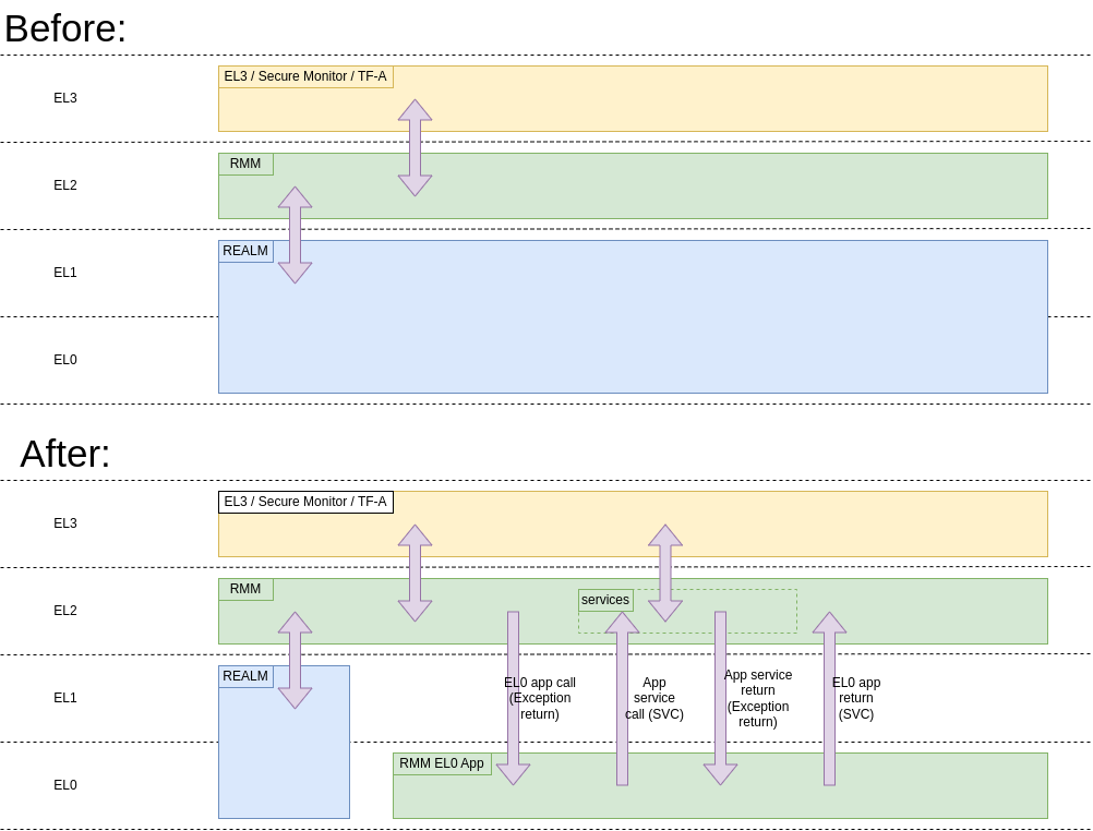

The goal of introducing EL0 app support in TF-RMM is to improve security by minimizing the amount of code running in privileged mode. This is achieved by deprivileging parts of RMM to run at EL0 using the Virtualization Host Extensions (VHE). This approach is especially desirable for code pulled in from external projects (like Mbed TLS), as such components are often complex and sensitive. RMM apps now run at EL0 using the EL2&0 translation regime, with the CPU configured such that an eret instruction in EL2 transitions directly to EL0, and the target EL of an SVC instruction is EL2. Additionally, each EL0 app has its own isolated address space, which not only improves fault isolation but also helps mitigate speculation-based side channels, allowing secrets within apps to be better protected from speculative execution. This isolation mechanism also lays the groundwork for future side-channel mitigations and facilitates their deployment. Overall, this scheme is especially useful for sand-boxing complex and sensitive code at EL0 and increasing the robustness of RMM.
RMM app EL0
This design document covers the various aspects of the implementation of the EL0 app support in RMM.

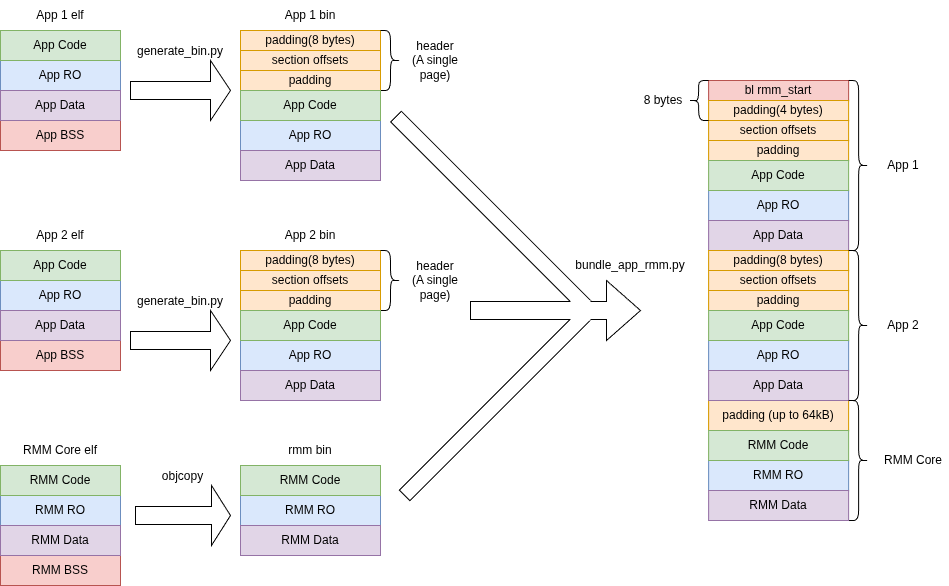

The RMM core code is built and linked using its own linker script. Then objcopy is called on the resulting elf to extract the sections to an img file. Then the bin files for the RMM apps are built as described above. The final RMM image is created concatenating the following elements by the python script app/bundle_app_rmm.py:
  • The first RMM app bin. The first 8 byte padding of the header is updated to a BL (branch with link) instruction, followed by 4 bytes of padding. This allows the offset of the first meaningful field - the section offsets in the app header - to remain consistent with its position in the original app binary. The BL instruction branches to the start of the text section in the RMM core img. The BL instruction uses PC relative offset to encode the branch target, so the instruction can be calculated when the bundled image is assembled. The return value that is saved in the Link Register by the BL instruction is used by RMM core to determine the memory address of the header of the first app in the bundle.
  • The rest of the RMM app bins (if any) unmodified.
  • The RMM core img file aligned to 64KB offset to meet ELF loader requirements.
The packaged RMM binary must be loaded at a 64KB-aligned physical address to ensure that the RMM core itself is also 64KB-aligned. This alignment requirement stems from the use of a 1:1 virtual-to-physical address mapping for the RMM core. In contrast, EL0 apps run at virtual addresses determined at compile time, which are already 64KB-aligned. As a result, the physical address alignment of app binaries is not significant.
The number of RMM apps expected by RMM core is hardcoded in RMM core. The RMM app headers are parsed by the RMM core during the coldboot phase. The RMM app headers contain a magic value, so if less than the expected number of RMM apps is added to the final bin that can be detected, then boot fails in that case. If more than the hardcoded number of RMM apps is present, RMM boot fails as well.

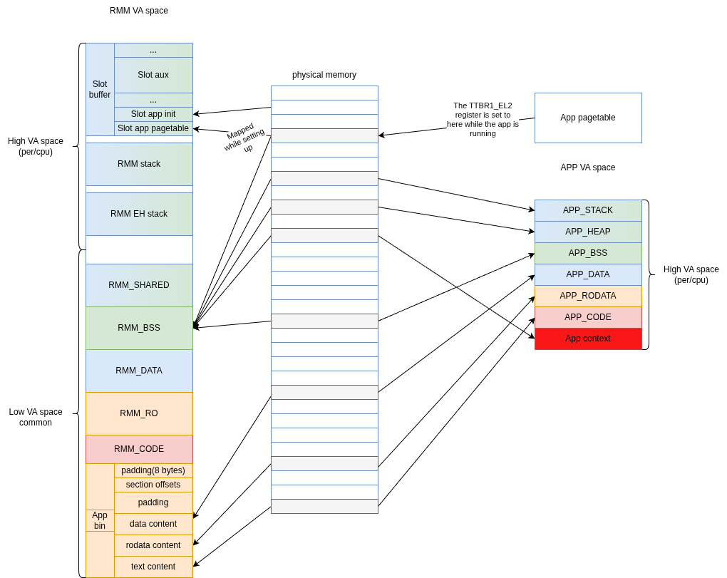

As it is possible that the pages are delegated by the host, and the pages need to be mapped dynamically using slot-buffer framework, a new slot is added to the slot buffer. When initialising such pages, the page under initialisation is mapped into this new slot, and unmapped after initialising.
The app_new_instance function receives an array of physical addresses of the pages to be used for the RMM app. In case of initialisation the code checks whether the PA is in the range of the RMM core’s rw PA range. If so, it can write to it directly. If not, the slot buffer mechanism is used as described above.
Mappings when using AUX pages for RMM app RW memory:
RMM app memory aux
Mappings when using statically allocated pages for RMM app RW memory:
RMM app memory static

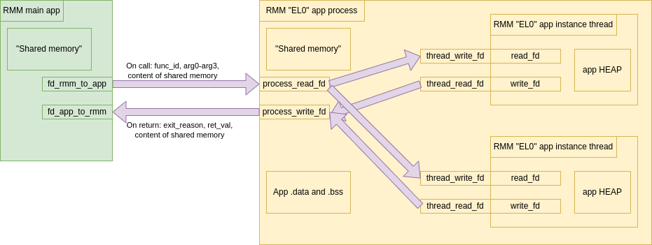

In case of the fake host build, the applications are compiled as a standalone elf file. The RMM core is compiled to the elf file rmm_core.elf. RMM core expects the app ELF files to reside in the same directory as the RMM core executable. The first time the main RMM process calls app_new_instance the process is forked, the image of the requested RMM app is loaded in the new process, and a pipe connection is established between the two processes. When the RMM app process is created, for each app_new_instance (including the first call) a new coroutine is created using the minicoro library. The main thread in the RMM app process dispatches commands from the main RMM process, resuming the appropriate coroutine which then reads from and writes to the process pipe directly.
There is no shared memory between the main and the RMM app processes, memory sharing is emulated by sending over the content of the main process’s “shared page” to the RMM app coroutine on an app_run call, and sending back the content of the RMM app coroutine’s “shared page” on RMM app function return.
RMM app host
The help of the main process:
