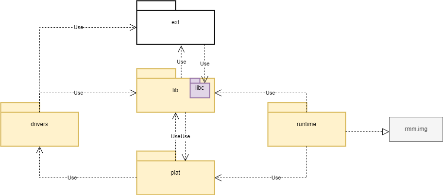

The RMM functionality is implemented by files in lib, ext, drivers, plat and runtime. Each of these folders corresponds to a component in the project. Every component has a defined role in implementing the RMM functionality and can in-turn be composed of sub-components of the same role. The components have their own CMakelists.txt file and a defined public API which is exported via the public interface of the component to its dependent users. The runtime component is an exception as it does not have a public API.
The dependency relationship between the top level components is shown below :
Dependency Diagram
Each component and its role is described below :
  • lib : This component is a library of re-usable and architectural code which needs to be used by other components. The lib component is composed of several sub-components and every sub-component has a public API which is exported via its public interface. The functionality implemented by the sub-component is not platform specific although there could be specific static configuration or platform specific data provided via defined public interface. All of the sub-components in lib are combined into a single archive file which is then included in the build.
    The lib component depends on ext and plat components. All other components in the project depend on lib.
  • ext : This component is meant for external source dependencies of the project. The sub folders are external open source projects configured as git submodules. The ext component is only allowed to depend on libc implementation in lib component.
  • plat : This component implements the platform abstraction layer or platform layer for short. The platform layer has the following responsibilities:
    1. Implement the platform porting API as defined in platform_api.h.
    2. Do any necessary platform specific initialization in the platform layer.
    3. Initialize lib sub-components with platform specific data.
    4. Include any platform specific drivers from the drivers folder and initialize them as necessary.
    Every platform or a family of related platforms is expected to have a folder in plat and only one such folder corresponding to the platform will be included in the build. The plat component depends on lib and any platform specific drivers in drivers.
  • drivers : The platform specific drivers are implemented in this component. Only the plat component is allowed to access these drivers via its public interface.
  • runtime : This component implements generic RMM functionality which does not need to be shared across different components. The runtime component does not have a public interface and is not a dependency for any other component. The runtime is compiled into the binary rmm.img after linking with other components in the build.
